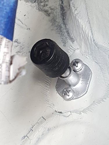

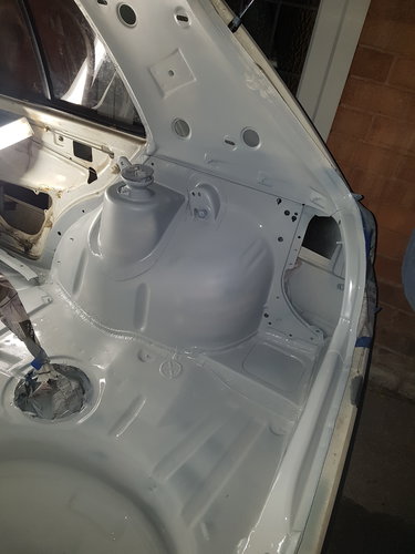

    It's the little things that give a lot of satisfaction . As I have painted the floor back to the rear seats I decided to freshen up the accelerator pedal stop.
    She's outside so this isnt the best weather for what I want to get done to her.
    Just need to sort tightening the suspension strut nuts correctly now that they are both on the car.

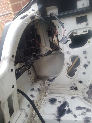

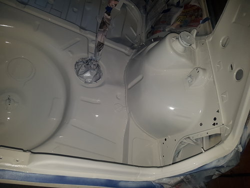

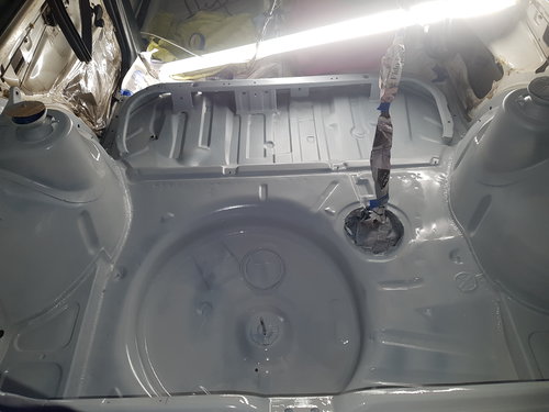

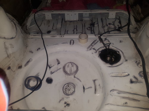

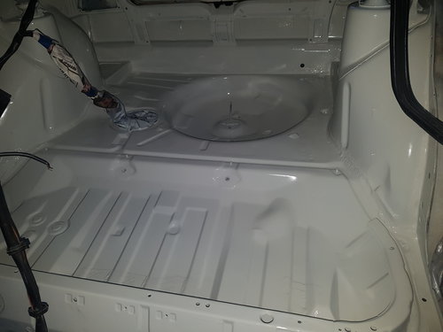

    I did empty the back of the car out today and spent hours sanding and preparing.... what a ball ache. It wont be a professional finish but it will be better than the scratches and rust spots. Even though it will all be covered by carpet! atleast it should last a good few years more.

  13. Cressa Paid Member Paid Member
    Aug 12, 2021
    282

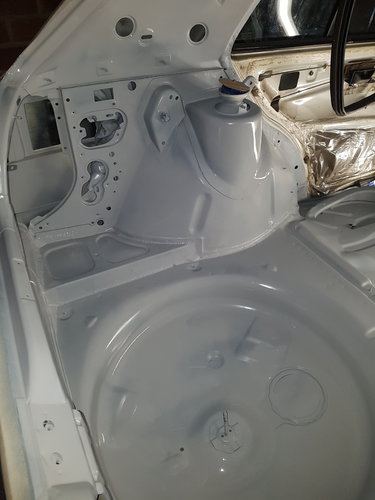

    Got some primer on. It won't be perfect but better than the rust and scratches

  14. AKAeddypeck Forum Member
    Oct 30, 2014
    133
    Looks like that'll be good enough, don't do yourself down.

  17. Cressa Paid Member Paid Member
    Aug 12, 2021
    282

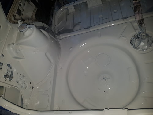

    3 thin coats Alpine white, just need it to dry fully.

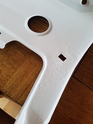

  19. Cressa Paid Member Paid Member
    Aug 12, 2021
    282

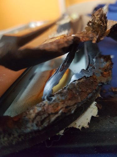

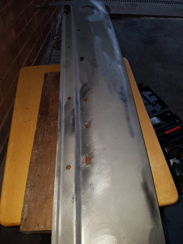

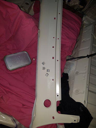

    I have done a little more. My rusty horrible lower front valance came back from being blasted, so that has had a coat of zinc primer on both sides and I have painted the inside.
    I even bought a set of dent/panel tools for £20 and set about sorting the dings and damaged/bent clip areas which was remarkably easy and all are now flat. The paint shop want me to leave the outside for them, fair enough
    The more I dig into, the more parts I find missing and they are all daft clips and screws that will pain me to find.
    I started on the inner roof area and that has had 2 coats of rust treatment. The sunroof tray awaits a flexible drill attachment so that I can de-rust.
    But I have removed all of the sunroof. I must say, this is simple compared to a corrado but I am missing parts so just need to find someone that has a cannibalised one that I could have some bits off. I shall put a wanted ad up!!
    My rain deflector plate had seriously rusted through and is now on the scrap heap.
    Rusty picture attached.
    So nothing nice until I get to paint these areas

  20. dodgy
    Good work on the front panel, panel tools are great, glad it didn't end up like father Ted's rover.
    Was lucky with my deflector as it was saveable but my side arms had rotted to some lovely tetanus inducing needles, managed to get stainless replacement ones but big bucks.
