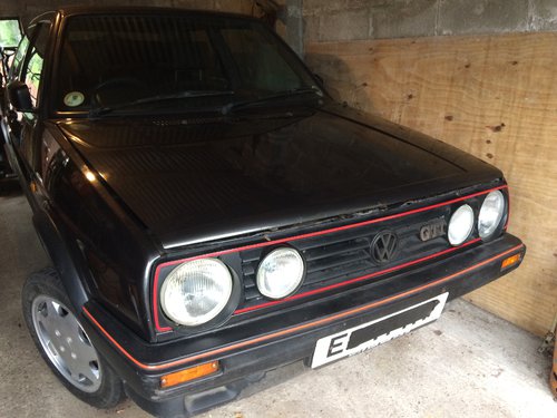

    Hi,
    Finally beginning process of reviving my 88 GTI campaign 8v.
    Put car into dry storage fully running and undamaged in 2001. Always started engine once or twice a year just to check. Some time in 2010 car would not start. Noticed that the familiar buzz of the fuel pump priming was silent so presumed a FP issue.
    Put issue on long finger for years just not having time to tackle.
    Last week removed both pumps and neither work with a 12v supply. There is about 1/3 tank of petrol which dates back to layup in 2001. However bottom of tank is clean and fuel looks clear ie no gunk.
    I intend to drain and replace fuel with 97oct. Have ordered replacement pumps and filter.
    Hoping that after a bit of coughing she will fire up???
    Timing belt was changed about a year before layup in 2000.
    I’ve turned over the engine a few times and all sounds ok.
    Coolant res was empty an presumed completely evaporated but res tank only took about a litre to top up.
    All rubbers look ok with no dosing or obvious cracking however wonder how they will deal with pressure once started.
    Just wondered if there are any risks or precautions I should take before attempting to start.
    I intend to change timing belt due to age but hoping a 20yo belt will withstand a few minutes gentle running and tick over???
    I’m sure there are many out there at this early stage of resto.
    Any advice greatly appreciated
    Bob

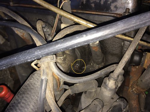

    Managed to get car out of garage into open for first time in 19 yrs. a good wash and dry and a chance to inspect more closely. A few more little rust spots but still relieved it isn’t much worse. For now I’m concentrating on engine and cooling system before a major brakes overhaul. But hey she’s moving under her own power. Still chuffed that I only had to replace the two fuel pumps and filter and she started. Ticking over more quietly now.
    I’m gambling on the 20 yo timing belt not snapping whilst I move car in and out of garage to do bits and pieces. Not sure I could tackle a TB change without a proper lift. I’ll trailer to mechanic I think.
    So now my focus is on the cooling.
    Pretty sure that coolant is not circulating through all hoses. Expansion tank is full but only top rad hose gets hot but when squeezed no sound of coolant inside and no level movement in exp tank.
    Idled for 15 mins to watch temp needle and wait for fan to cut in. It didn’t??
    Tested fan with 12v and it works.
    Afraid to run any longer. Some steam coming from rad. Also a little coolant escaping from area circled in photo don’t know what this component is??
    Any advice welcome.
    there is rust and corrosion along the edge of rad so I expect a new rad would be wise.
    is there a fuse for the fuel gauge sender? Not registering at all. Was very careful with it when fitting the in tank pump. New senders are expensive I think???
    this is a long road it seems but “I’ve started so I’ll finish”
  19. Savagesam
    1,080
    The picture is your thermostat housing. The oring is probably knackered.
