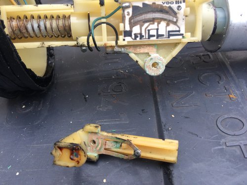

    Another general question to all.
    Having very carefully fitted new in tank fuel pump and added 20l fuel the fuel gauge is not registering. Whilst float sender Was out all wires were soldered and intact. Can there be an issue with the contact wiper. Do these fail after periods of non use.
    Is there a fuse to check?

    for fuel level sender, first thing loop a wire between the brown and purple/black on sender. if it goes to full, wiring is ok. if not check you have earth on the brown wire, should see voltage on the purple/black from the gauge.

    Got fuel gauge to work again and delighted not to have to mess with clocks.
    Not sure who gave the tip on how to check if gauge is working by bridging the purple and brown connector pins with ignition on. Whoosh straight up to full tank so gauge and wiring is good.
    So issue must be with sender. Bit miffed at having to haul the tank pump out again after recent installation but needed to investigate.
    Trusty multimeter to check continuity of wires....all good?? So issue must be wiper or VR track. No continuity to wiper which seemed strange. Decided to disassemble wiper pivot and immediately spotted the white dusty corrosion on wiper copper contact see photo. Cleaned extremely carefully with steel wool to a bright shine. Sorry should have taken photo of the after. Reassembled wiper pivot and tested resistance at pins as float arm moved. Bingo!
    Pump and sender back in tank ignition on and 1/2 tank registering as expected.
    Delighted to check off another job.
