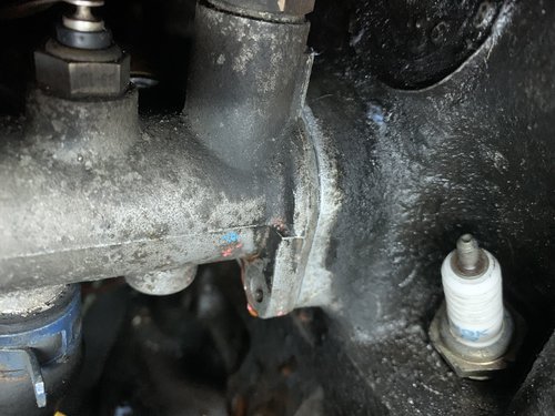

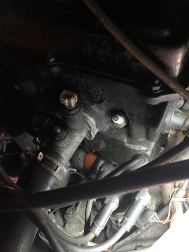

    Need a bit of assistance with a stubborn leak in coolant system on PB 8v.
    Have had a problem with a leak on this flange at the front of the block.
    Replaced O ring and 3 attempts to seal along with additional instant gasket.
    Simply topping up the header tank causes steady drip from base of this alloy cast flange.
    I think the casting must be cracked just above the lower securing bolt.
    can anyone tell me the correct name of this part. (Please see photos)
    are these easily sourced?
    any advice welcome
    cheers
    Rob

    I can see plastic flanges on eBay but there are the two sensors on the top of this alloy original. Can’t see how these sensors would be transferable to one of these plastic flanges.
    Would be great to hear from someone who has replaced one of these.
    Rob

    Would the two heat sensors unscrew from the alloy and screw into the plastic flange. Is the plastic flange threaded on the top to receive the sensors.
    Perhaps it is which would be great....

    Is the part from VWH not metal Rob? It looks metallic to me and certainly looks like the original.

    thats not the right one, you need 027121133A if you keep the alloy front flange. The difference is A part has an extra hose connection on the bottom for the oil cooler setup. If you want to move to plastic flange you also need to replace both coolant sensors with associated o'rings and clips. The ecu temp sensor plug will fit the new blue one but you'll need to splice 2 pin plug to coolant temp and add earth to 2nd pin.
    if its leaking that badly have a close look at the flange and the head, must be a crack somewhere if not heavy pitting on the seal face. give it all a really good cleanup and see, fingers crossed its the flange and not the cylinder head!

    Thanks guys. think I’ll play safe and stick with an alloy flange as recommend by RJ.
    Guys at VWH very helpful today but only have plastic flanges with different sensors . Will keep ringing around and hope I can source one.

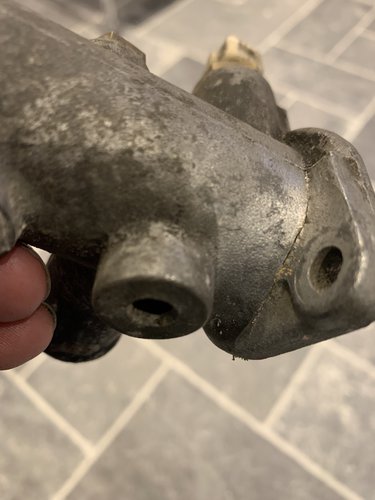

    Well I found the culprit there is a crack where the coolant is weeping from. Think I’ll try to source another one of these alloy flanges. They’ve got to be better than the cheap plastic ones.
    just wondering if this crack could be sealed with that plastic metal epoxy smeared on the inside and outside of the crack. Probably a waste of time?..
  13. rubjonny
    its worth a try for sure :)
