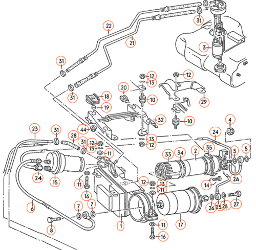

    So I also thought maybe the fuel is syphoning from the tank so I disconnected the left hose on top of the lift pump assuming the arrow out meant to the lower pump. Fuel kept coming.....
    Will now take your advice and disconnect the blue hose on right. I’ve ordered another main pump. Cheers for the information re. Blue hose

    Can I also ask....does fuel flow from filter to accumulator pump and then to injectors or does it flow from accumulator pump through filter and then to injectors???
    It’s just when I pulled off the pump to filter link hose there was no fuel in it after all those start attempts and I thought this was strange I thought the filter would be full???
  9. H8V
    h8v Forum Member
    Jan 13, 2012
    92
    Here you are...Pump outlet to filter, filter to injectors. There is an arrow on the filter for fuel flow direction.

    Thanks for the diagram
    So a dry link pipe from pump to filter suggests no flow through pump.... well done Sherlock

    Just seen that yours is an '88 car, so you might have this layout... either way, it looks like you've found that problem.. so obvious when you know the answer.

    Thanks hv. I do hope this new pump solves the problem cheers for the diagrams
