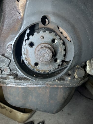

  1. GTIBOB
    Aug 7, 2013
    North of Ireland

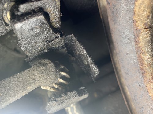

    Eventually managed to prise off pulley.then discovered WP pulley also has to come off. Similar wrestling match and skinned knuckles but now pulleys and covers off .So belt and tensioner next. Bit annoyed tensioner is not a self adjusting spring loaded so have to wing it to get tension correct. Now need to get one of those tensioner levers with the two pins unless anyone has an alternative that works
    Not oil just WD on old belt

    Have used right-angled circlip pliers before, the proper tool is better though.
    Make sure you mark the gear that drives the distributor so the ignition timing stays correct.

    Invested in Tipex already. Won’t be letting anything move a gnats whisker. Hoping the worst that can happen is timing might be a little out but being a non interference engine I’m not that concerned.
    Be interesting to see what first startup with new belt goes like
    3,576
    you can al;so use the '1 allen key' method. put your socket on the tensioner nut, fit allen key into a tensioner hole and push down on it bracing to the socket till you get required tension, nip nut

    So timing belt now changed. What was I worried about? Well not exactly every stage had its own frustrations.but hey we’re here for the success stories. So just before fitting top belt cover I wanted to start up to see how belt was tracking and if any noises. Started then stopped, just wouldn’t run. Thinking you’ve done it now. Then noticed I hadn’t refitted the throttle body to the air intake ducting which I had removed for access. To much to hope for but I re connected the duct to the air filter and started up perfectly to about 800 idle. Was assured belt replacement was a breeze and whilst I wouldn’t describe it as a simple process it’s very doable with patience and few decent tools. Almost bottled it and was going to get local garage to do it until the sucking through the teeth started...” you never know with that old stuff bolts seized etc could take a day £280 labour” so decided on principle let’s do this. In no small way due to encouragement on here I can now say I’ve done a cam belt change for the price if the kit. Scrubbed the rust off the metal top cover primed and sprayed black. Icing on top putting on the sticker with the date and miles when changed. Sad but true.

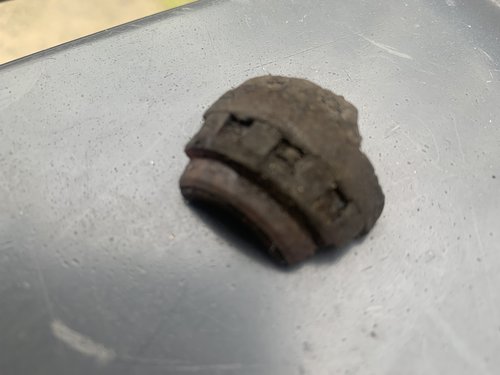

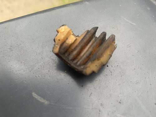

    So after moving the GTI back into garage I find this on ground.
    Putting the experts to the test
    Name this part ( answers on a postcard) BE8A9FD8-8C46-40AA-B8BB-AD8761E970C7.jpeg 50884405-36EA-4B6F-8001-956AD1CDDDB5.jpeg

    So I reckon this is the remnants of the shift relay lever ball
    This is where I suspect it used to be (see pic).
    I see lots of kits for refurbishing the gear linkage.
    Should I just replace the ball or is it worth getting a full bush kit.
    There is now about 50mm play in stick although all gears can still be selected.

    I reckon it's always getting the full bush kit, and also the spherical bearing at the bottom of the gearstick.
    Makes it seem like a new car!

    Cheers for the links...great help. finished replacing all the linkage bushes tonight. There is a bit of vertical play in the gear lever but not that noticeable. I’ll do the ball and gear shaft bushes in summer.
    Didn’t realise how bad some of the bushes were. Worst were the relay shaft top and bottom they just crumbled and fell out. To be expected I suppose.so good to get these done.
