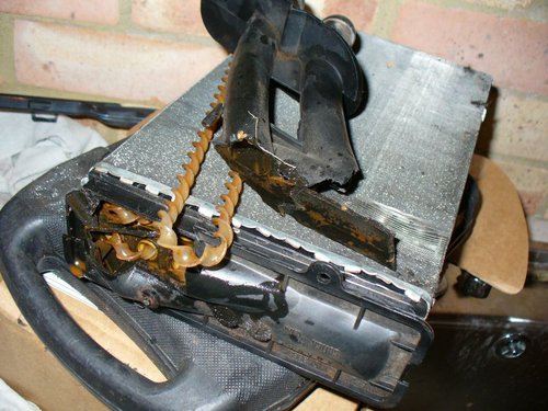

    The mod done by VW had one of those alloy valves on each heater hose, joined by a small rubber pipe. I can only see one alloy valve on yours. Anyway, it's probably best to revert back to a straight connections to give a good flow.

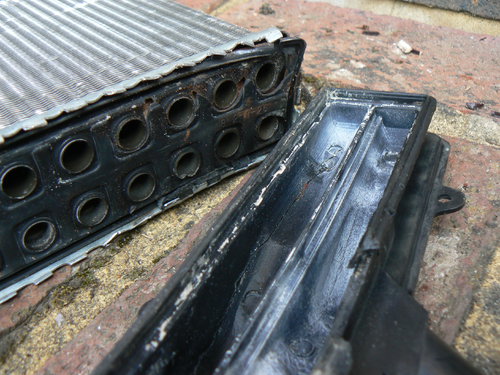

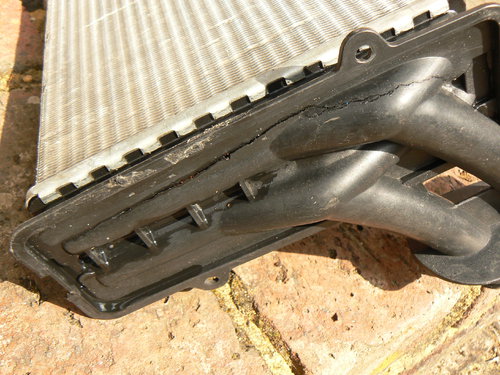

    As luck would have it my matrix split a couple of weeks ago. I wasn't driving but the car had been sitting in traffic and overheating. Despite the coolant filler cap having a release pressure of 1.5 bar, the matrix burst. A bit of a mess, and anti freeze doesn't evaporate away! You can see the crack all along the top in one of the pics. The cause has been resolved; the rad fan cables have a plug and socket connection behind the n/s headlight and it had rotted away. I've now replaced the rad fan cables with ones straight to the battery, with soldered ring connections as a more lasting arrangement.

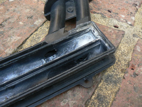

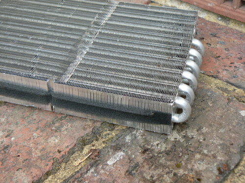

    Out of curiosity I dismantled the matrix. Here are some pics. The coolant flows in to one side of the plastic cap, down the alloy pipes, then back up to the other side of the cap and out of the return hose. The cap sits on a rubber seal all around the pipe ends and has a divider along between the flow and return pipe ends so I don't see there is chance for any coolant to avoid going around the alloy tubes. If you were getting a good flow both ways when flushing and you say a lot of muck came out, then I reckon the matrix should still be functioning OK.
    Try removing the valves in the flow and return pipes and see if that helps. I can't see any reason for the hot coolant to not flow through correctly. You will need to rev the engine a bit to get the coolant to begin to flow uphill through the hoses, but once it's started it should be OK.

    the way the matrix are made means even if you get flow thru, doesnt mean the unit itself is still clogged. as long as at least one of the core pipes has flow water will get thru it, even if all the rest are shot

    the matrix above is actually inferior design to original OEM, as those have plastic inserts pushed down the cores to force the water to move around more transferring more heat. the downside is they clog more easily, and when they fail you end up with chunks of 'curly pasta' in the coolant tank

    (It was a Nissens 73961. In a nice box, but no markings on the actual unit!)
    Sorry, the new one is a Nissens. That old one was only about 10 years old and from either GSF or ECP/ CP4l I think.
    Final edit... the old one was from Euro Car Parts. £21.30 New Nissens £20.88

    If there is good flow both ways when flushing through the matrix then at least some of the tubes are flowing, though as RJ says, it's no guarantee that all are fully clear. If you look at my first two pics, you can see the divider moulded across the centre of the plastic cap, separating the 'in' and 'out' ends of the tubes and the sheet of rubber to seal things, so it seems impossible for coolant to avoid being compelled to flow through the matrix tubes.
