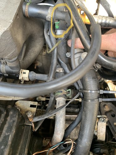

    Decided to do a complete coolant flush and at same time try to flush heater matrix. Main flush went to plan with a surprising amount of gunk given it was flushed about a month ago.
    So on to matrix hoses.
    Took advice and disconnected hoses at engine and tried a gentle back flush. With garden hose I wasn’t getting any through flow. Moved to in pipe and no flow. Back to other hose and through flow started. So now have clear water flowing in both directions it seems through the matrix. BUT when connected back up with new coolant still no heat???
    Both hoses to / from matrix are hot.
    Strangely the left hose is cold where I have circled towards bulkhead but hot below where I’m pointing.
    Don’t really understand how there is no heat when there is flow through matrix.
    I’m resigned to replacing the matrix down the line and disappointed the flush didn’t work

    If matrix flow and return pipes are hot, then matrix must have flow, as you have already shown with the cold water flushing in both directions.
    Therefore it seems that there is an issue with the heater flaps rather than the matrix....perhaps the temp control flaps.
    You could get a better look at the operating cables if you take out the driver side under dashboard shelf and the centre console around the gear lever.
    That would give you better access to the heater box and you could feel for heat in there and figure out what is happening.

    Hadn’t thought of that possibility. I definitely have flow in both directions through the matrix. But the top of the return hose close to where it comes through the bulkhead stays cold when engine gets up to temperature. There’s a hard black plastic fitting on return hose circled in photo below it is hot but above it is cold. Strange
    So if I remove centre console I can see if the flaps are opening or closing? Is it possible that flaps could be stuck in a position preventing heat getting out?
    Would I be looking for anything in particular
    I think the cables are fine but need to investigate. Fortunately don’t seem to have any wet carpets so matrix not burst??

    VW did a recall to add a mod to the hoses about 20 years ago. That aluminium gubbins you have in the right hand heater pipe is part of it. There should also be a small rubber hose going from it to a similar similar part in the left hand hose, but yours seems to have had that replaced with a piece of straight pipe. One of the effects of the mod was to reduce the flow through the matrix.
    I would first remove whats left of the mod by taking out the aluminium bit and replacing it with a straight pipe, like your left hand hose. You could alternatively just replace the two hoses with a pair like either of these to get the flow back to normal.

    Checked and I do have the little link rubber hose from the aluminium mod as you describe it over to the return hose. It gets hot also. Just wondering if should clamp this and see if that will force flow through matrix.
    Could there still be a flow through a blocked matrix ie. perhaps the water can pass through and out of the top of the matrix without flowing through the core ?.
    Water pump is definitely working as return flow into reservoir tank is steady on idle and increases with revs
    Will have to investigate further
