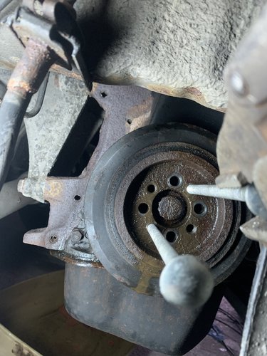

    Hi
    Just doing battle with this crank pulley. Delighted the four studs came out without rounding off.
    Now I can’t get the pulley off and have no room to tap it off.
    I am thinking if I screw these two coach bolts in and move around the Four 6mm holes I should be able to force pulley off the spline.
    These bolts match the threads of the holes and when I screw them in I assume I’m pushing against the block somewhere.
    Could I cause any damage if I tighten these bolts against whatever they’re pushing against. Am I pushing against the lower plastic cover?
    A quick reply would be great as I’d love to fit this T belt tonight.
    Maybe I need a special pulley puller??
    Advice appreciated
