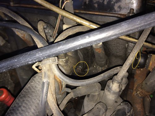

    Had car out to run engine today. Noticed coolant weeping from these two flanges circled in photo. Do you replace just the O rings or does the flange itself need replacing.?thanks

    the front one is alloy so keep that, just do the o'ring. when loosening and tightening do the 2 bolts gradually otherwise theres a risk you'll crack the housing. side flange is plastic, just replace the whole thing it'll be warped.

    Replaced plastic flange on side of block and seems to be sealing.
    Replaced o ring on front of block coolant alloy fitting but it’s still weeping. I’m reluctant to tighten the two screws any further and risk stripping threads.
    The old o ring was green and appears to be square sided rather than circular in section. Would it make any difference the section of the o ring re sealing. Tempted to try adding some instant gasket to see if I can get the alloy flange to seal.

    with the front flange take it off again and check head surface, if pitted wire brush it till clean and fill pits with chemical metal. sand smooth and try again. the original seal would have been round, its just been on there years and squashed square profile
