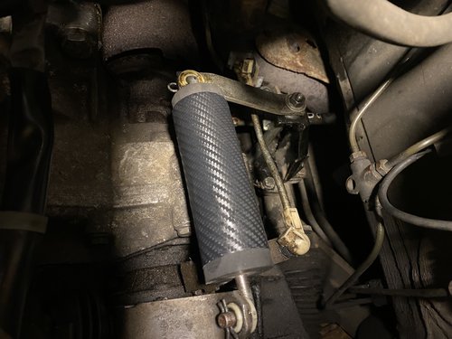

    Next project was to try to make myself a weighted shifter link. Might have just bought one on eBay but the few I’ve seen were £30 odd so time for plan B. Make my own.

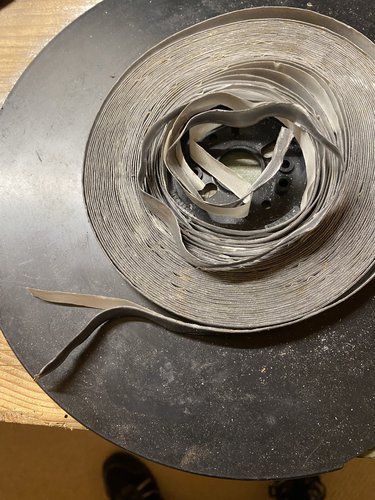

    So I recently rediscovered a roll of self adhesive lead strip as used to make leaded stained glass windows. Very heavy so I began to wind the adhesive lead around the link bar to about 50mm dia. And repeated about 10 times = really heavy. So then slipped some black plastic drain pipe over the lead. Had some thick heavy duty rubber so made and slid on these thick washers either end to prevent any slipping along link bar. Then covered pipe with some self adhesive carbon fibre sheet and think it looks ok.
    Can’t feel much of a difference in the shifting but maybe on road will be more noticeable.

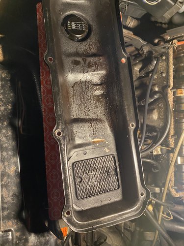

    Tonight’s job was to begin replacing the rocker cover gasket.
    So I have managed to get the cover and old gasket off.

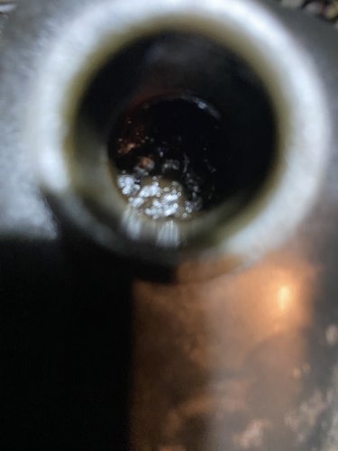

    Can anybody advise as to what to do with the mesh filter under the breather. As the photos show it seems blocked with black gunk. I’d say this is the first time the cover has been off. Should I thoroughly clean this breather with degreaser?? Should you be able to see light through the breather mesh??
    Advice appreciated before I refit cover.

    I reckon that cover could be soaked in petrol (or possibly diesel) to shift all that crud out of there

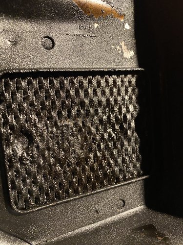

    Instinct tells me to clean it thoroughly with degreaser should it be possible to see through the mesh?? I’d say very little air could pass through at the moment. Can any harm be done? Is there some sort of filter inside

    Had a go at cleaning the mesh in the rocker cover with degreaser. Even with stiff sink brush not great results. The degreaser does seem to flow through but even if held up to a bright light can’t see any light through. Why is the mesh needed???
    3,382
    the mk3 rocker is just hollow, i suspect with the pcv valve its not so much of an issue but the rocker is shared with other models and/or vw didnt bother to re-design. there are a couple variants one which looks more like a windage tray and iirc there are some which are just plain inside

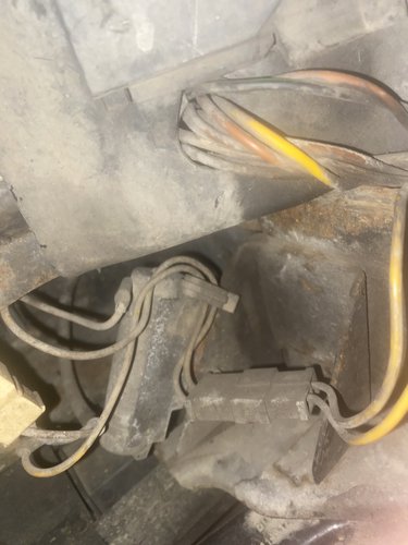

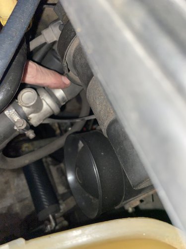

    Noticed the hose feels cold where pointing but other side of valve is hot. Can theses bypass valves stick shut and prevent hot water getting to matrix. The small return hose at bottom of valve is hot. I know it’s best to change the matrix but it doesn’t appear to be leaking but the car did sit for 21 years

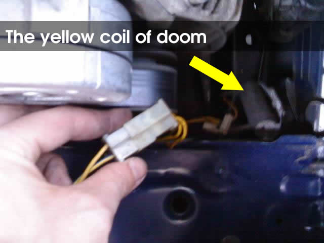

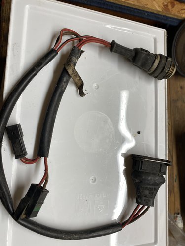

    Found this…..is this the infamous headlight resistor that people complain about. I recall I had a headlight replaced about 30 years ago and this was in bag with old light….??

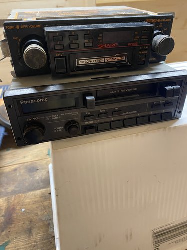

    Whilst rummaging I also unearthed these. The Sharp which I had in my Mk1 Jetta in ‘86 I believe. The Panasonic I think is also’80s.
    Going to try to power them up.
    I currently have a 23 year old JVC CD head unit which works well.
    Tempted to fit one of these older units because I have some great’80s tapes.
    Any comments on which of the two to fit to the Mk2 GTI
  13. costel1969
    629
    Don't think so - the one I removed was a about 2.5 - 3 inches long and cylindrical in shape with 2 cables on either end of it.

    3. Go with the Panasonic, far more cleaner look to it and would (in my opinion anyway) just sit nicer in the mk2 dashboard.

    Looks like the radiator fan temp switch - don't know why, but maybe from when the heater bypass valve was retro fitted (possibly by a dealer because that was a recall) - just guessing?
    Read somewhere they fail eventually too, better getting shot of it. A new matrix (that'll automatically be an upgraded MK3 item since that's all that's now marketed) does away with the need for it anyway - unless your particularly attached to it.
    Wouldn't bin it though, seem to sell when they appear on eBay for some reason!

    Is this the resistor?
    Lights main and dipped working well and quite acceptable at night.
    Should I leave well enough alone???
  18. costel1969
    629
    Yes that’s the culprit
  19. costel1969
    629
    Your call but I would take it out and pop a little lighting loom upgrade while you’re at it - very straightforward plug and play job

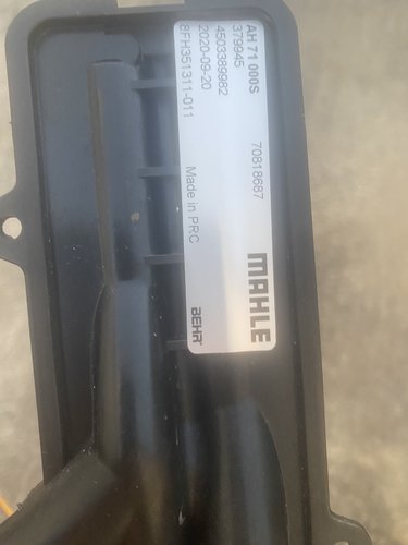

    So I have the new matrix for the Mk2 GTI (is this the correct one? Is it the preferable Mk3 upgraded one?)
    Going to roll up sleeves next week and make e a start on the tear down. Will most likely be on here regretting starting!
    Probably will be worth the effort
