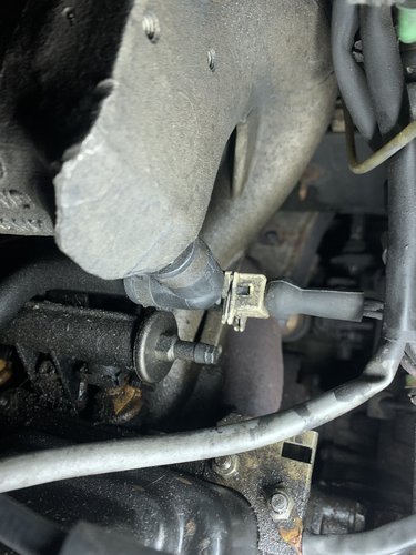

    Hi
    Can I loosen this nut on end of rail to check for fuel to injectors
  6. H8V
    h8v Forum Member
    Jan 13, 2012
    58
    Yep, that's an outlet to check the fuel pressure, I believe.
