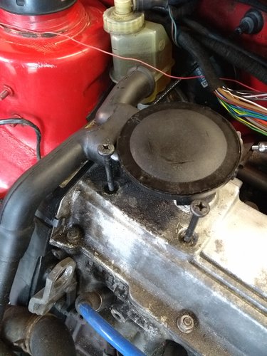

    This is presumably the crank case and cam cover vent. What is the best way to ditch it/route it more nicely? IMG_20211001_095802921.jpg

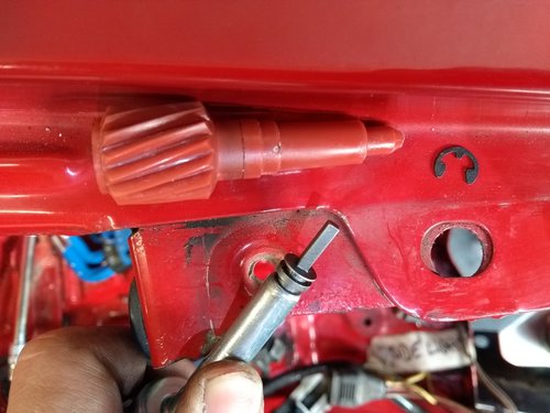

    I thought that the circlip went in the small groove and then the red gear slid over and clicked in place? With the circlip in place the gear will not slide over.
    Help please.
  5. PhilRyder
    So ignore the above post. I spoke to Heritage Parts (their website is truly awful) and they are sending out the correct circlip.

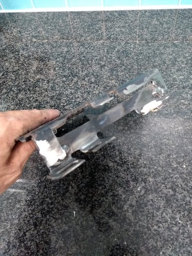

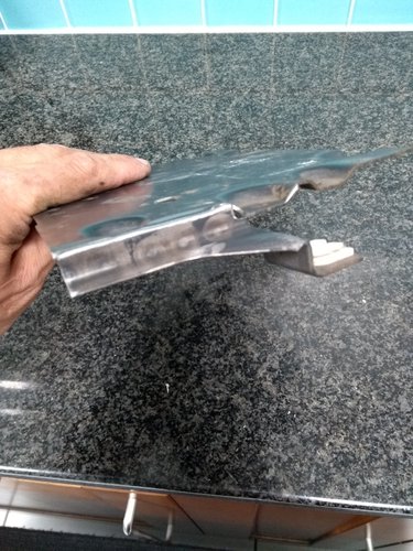

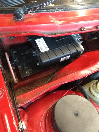

    For the ECU we decided on using the Mk2 coil amplifier support but is is too tall. So a bit of cut and shut.
    Et voila.

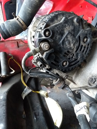

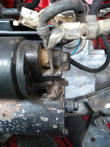

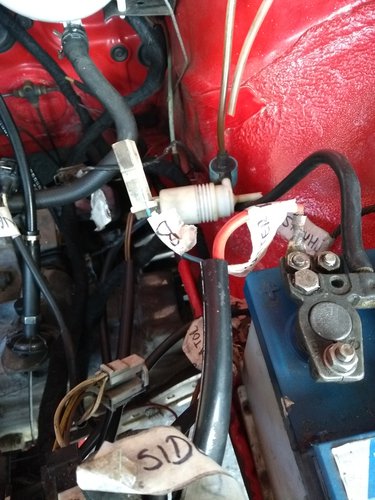

    We connected up the solenoid and the alternator. Can someone please confirm that the big fat wires are positive and in the correct position before we go firing it up.

    On the photo of the starter, are there two battery sized wires going to the solenoid? Thought only one on mine, and the alternator one went straight to battery, may be different on yours, or accidentally put the engine earth on by accident has been long days, I can't remember from stripping that mk3 couple months ago. Apologies if it's both positive, it just looked odd having 2 chunkies on the terminal.
    PhilRyder likes this.
  7. PhilRyder
    Yes, the cable goes from the battery to the solenoid and then a separate wire from the solenoid to the alternator, that much I'm sure of as they were labelled. Just had a mind fart about whether positive or not.
    Edited my post to put the correct text in the correct place - it has been a looooonnnnngg day [:v:]
  8. dodgy
    It was one of those that looked odd to me, but thinking about it that's how BL stuff did it, plus my mk2 was an auto so starter at the back may be why the alternator went direct to the battery.

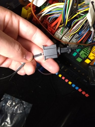

    Further, the red and white from the vagcom port, does that need to be permanent live or ignition live?

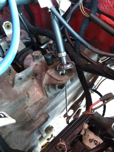

    I believe there is supposed to be a rubber grommet/washer under the round clutch brace washer thing. Is this right and if so is it available separately as it didn't come with the new cable.

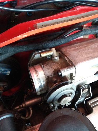

    The black hose with the white stripe coming out of the back of the throttle body is vacuum from the brake servo, correct?
    And lastly, for the moment, what should this banjo connector connect to? Was it to the charcoal cannister and if so can it be removed/blanked off?
