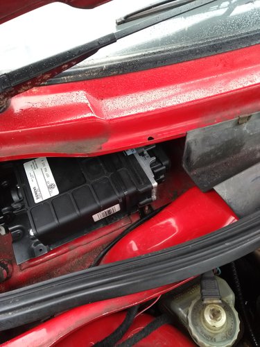

    As mentioned earlier in the thread the ECU is mounted as below. What concerned me was the drain hole right above the business end. I've seen and heard too many stories of ECUs ruined by water ingress so a bit of 3D printing ensued.

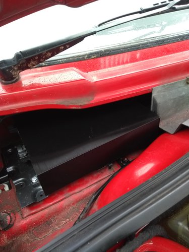

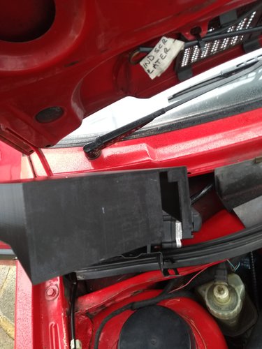

    A four sided box to go over the ECU.
    Simply attached with velcro.

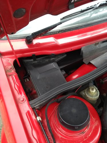

    And the original cover cut down to fit for a more standard look.

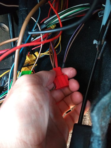

    While doing the fusebox we found this. Any ideas? 2 x blue and red wires and 2 x brown but only 2 pin plug.

  3. rubjonny
    Headlight range control motors, ignore :)
    PhilRyder likes this.
  4. PhilRyder
    Thanks Mate, I knew you would know :thumbup:
