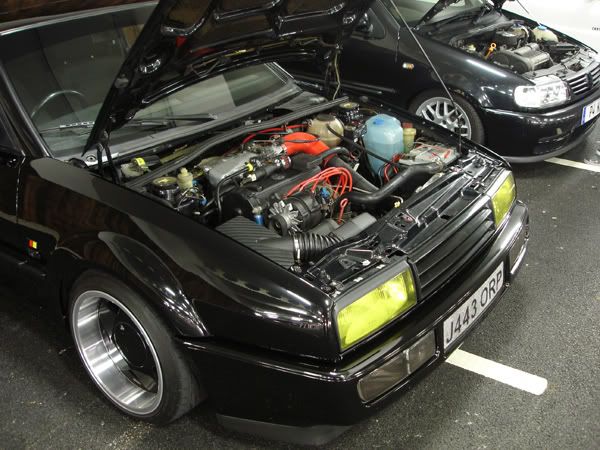

    Well after around 4 years! this problem is still there...
    Im now running a red top chip (Cheers Steve) and injectors, albeit for 300cc injectors instead of the 350cc injectors that im running.
    It hasn't changed the chracteristics of the problem at all... [8(]
    Ive rechecked the ignition timing, and its absolutely bang on 6deg btdc. Is it worth trying to go for 8deg? and see if it revs more responsively/stops the popping?
    Pics for views,just like on vortex...never understood it meself [:s] :lol:
    Neil.

    no harm in trying the timing at say 4 degs and 8 deg....although id be suprised if thats the prob
    have you double checked it with a another timing light

    have you tried it with the knock sensor undone?

    Its a new timing light...well it was when the problem appeared:lol: Since used to time friends cars up etc and all is fine.
    Ive tried running it with the knock sensor unplugged, but the problem is the same[8(]
